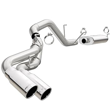

I'm thinking of getting a Magniflow exhaust #15333, but I've seen two different pictures of the same system. Is the piece after the muffler a resonator? And wouldn't that suppress the sound? Any thoughts....

The funny thing is the picture of the #15333 with the resonator is from the Magnaflow website, and the other is from Amazon. Which one would you get?:confused:
#4 ·
MagnaFlow website says the resonator is included. I would call MagnaFlow to clarify which is which. If it is the family vehicle I would use the resonator, if it's a work/play truck then leave it off. It's a totally personal choice.

I sent a message to Magnaflow asking them about the two versions, I'm just waiting for their response. I think I would prefer the version without the resonator.

Update on Megnaflow: They emailed me back and said Part #15333 only comes with the resonator even though Amazon shows it without one.
