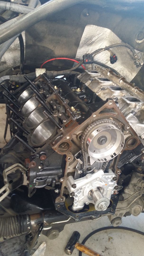

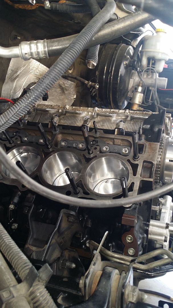

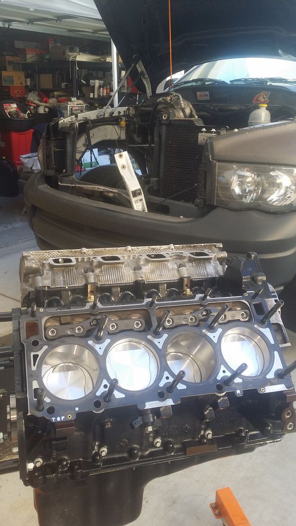

update for saturday..thanks to Eddies help, we were able to install motor and attached to tranny... because of the arp studs, we installed the driverside head complete before dropping into truck....also removed the arp studs closest to firewall to make it easier to install the passenger side head after motor was installed.. we installed without the one head initially in order to access the tranny bolts more easily...
