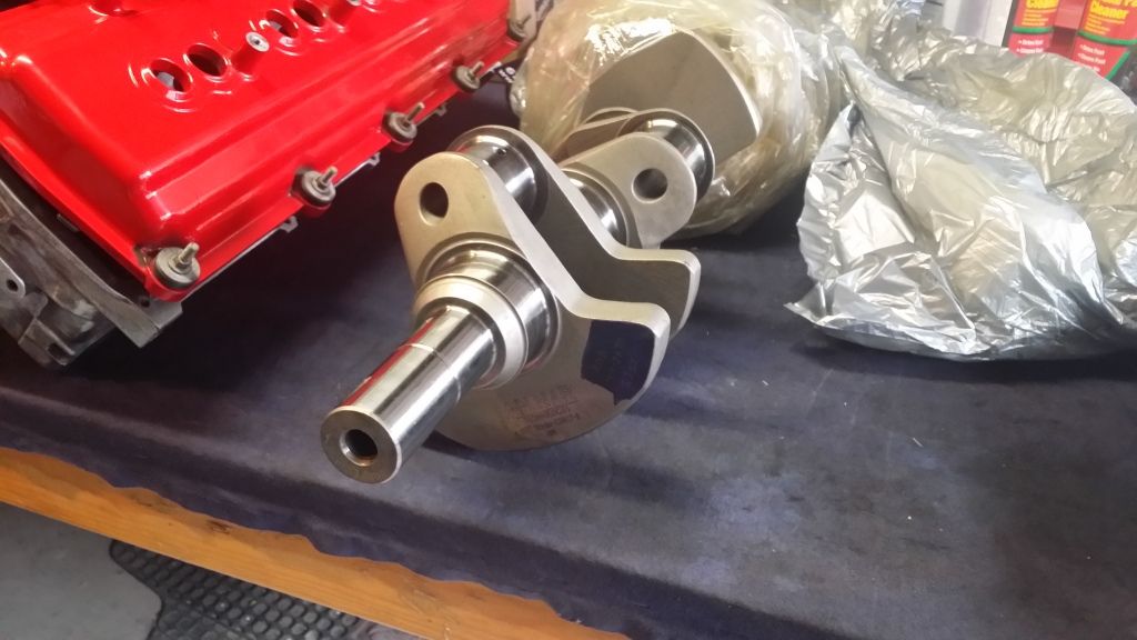

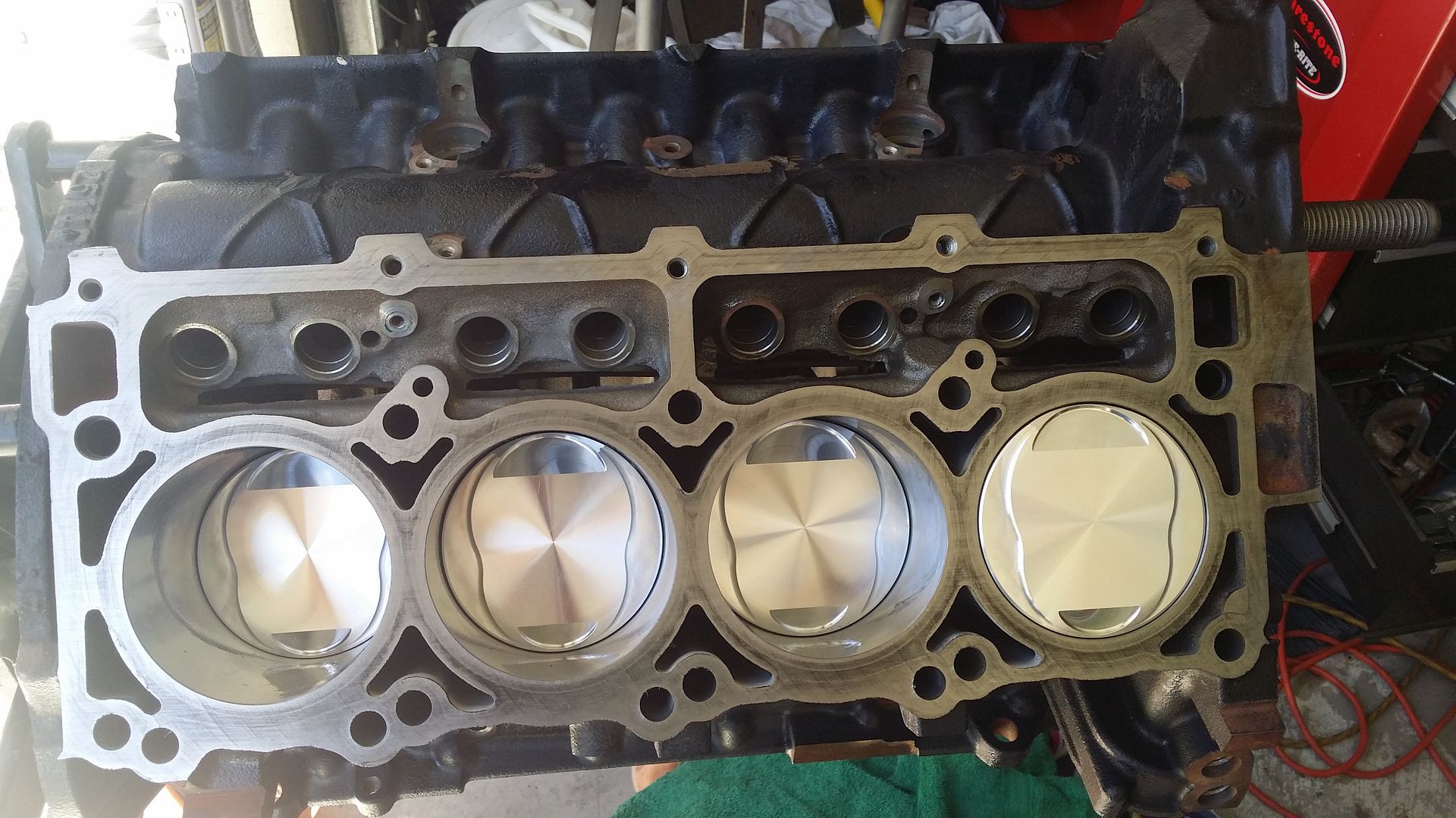

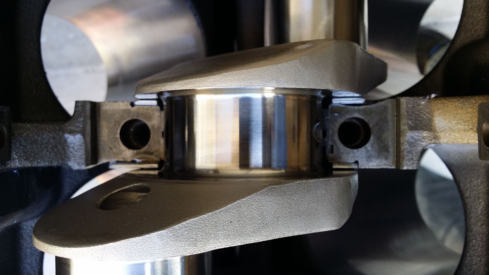

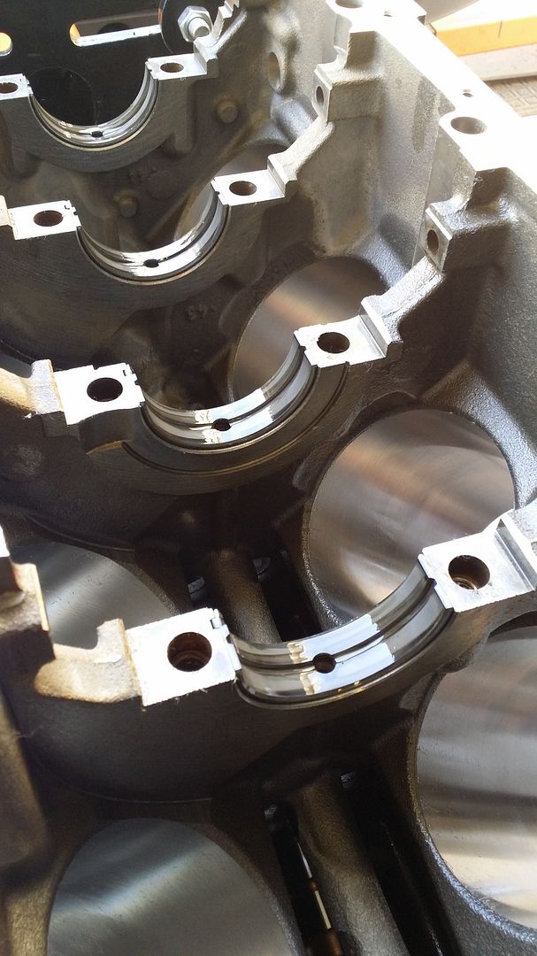

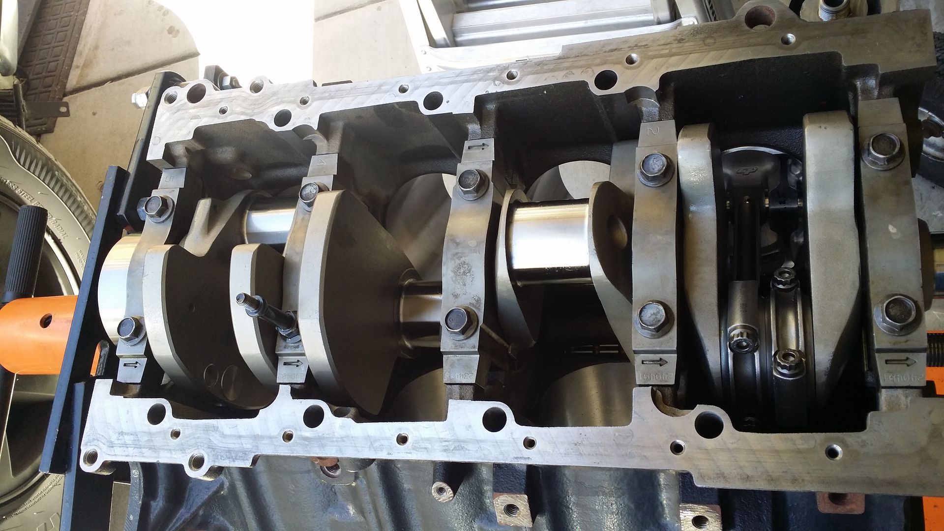

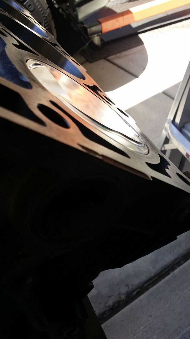

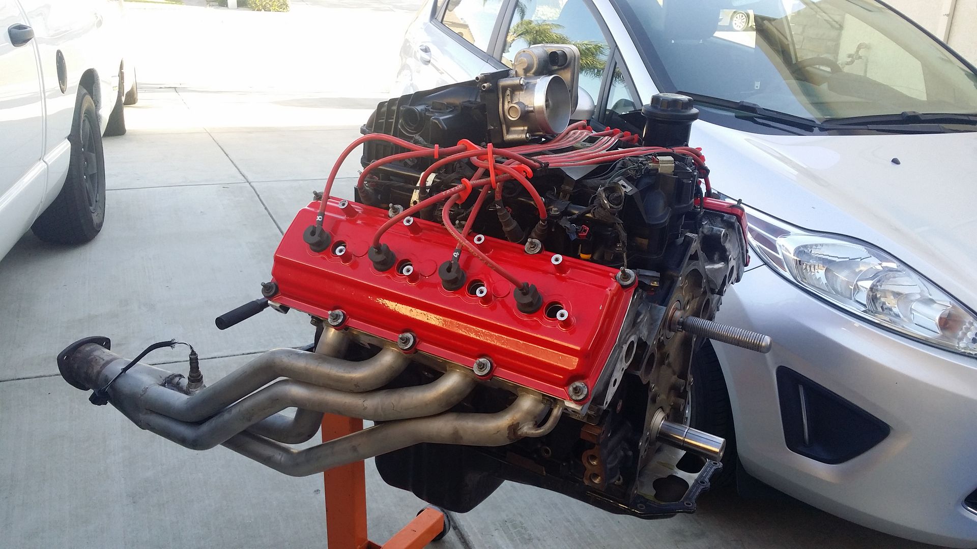

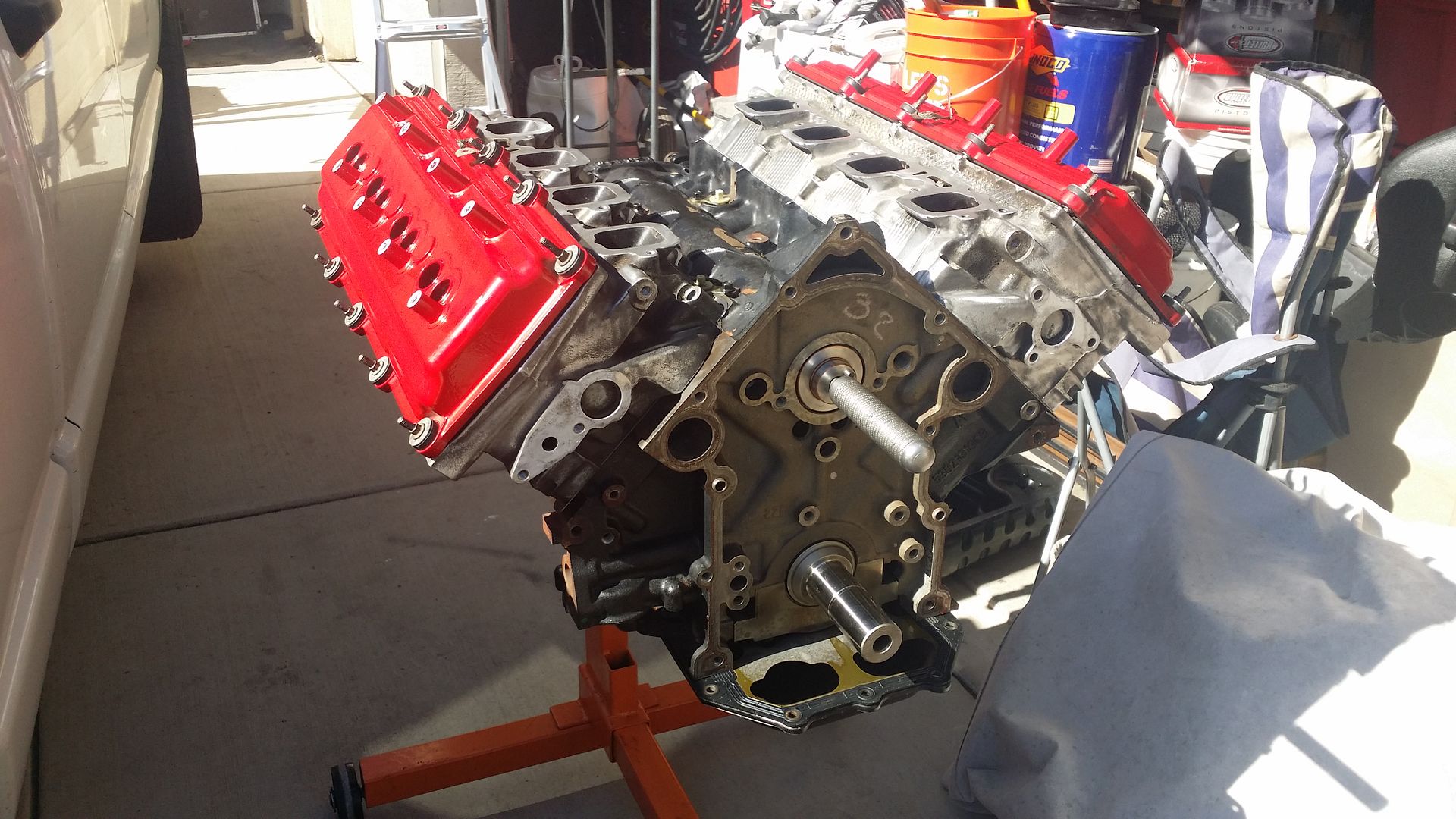

Merry Christmas to Me!!!

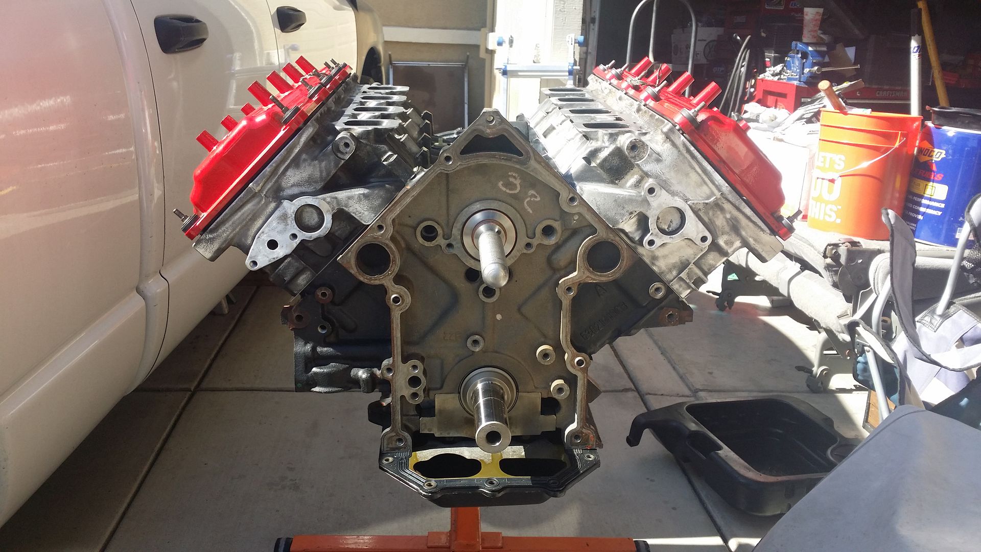

also pulled the mains..
this looks like I'm putting it together..not pulling it apart..

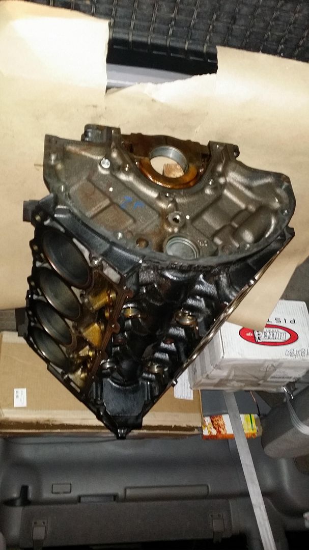

ready to go to machine shop tomorrow..

Other than the cam and lifters that motor is in unbelievable shape for that many miles. A real Amsoil testimonial! :thumb:
That's a lotta cam, it's going to sound absolutely wicked! :popcorn:

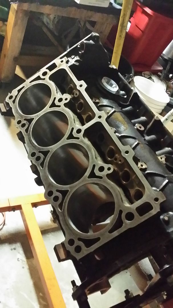

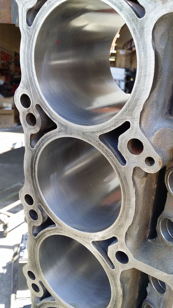

yea i hearya Bill...we'll see... i'll have to wait a bit to get a built one tho...

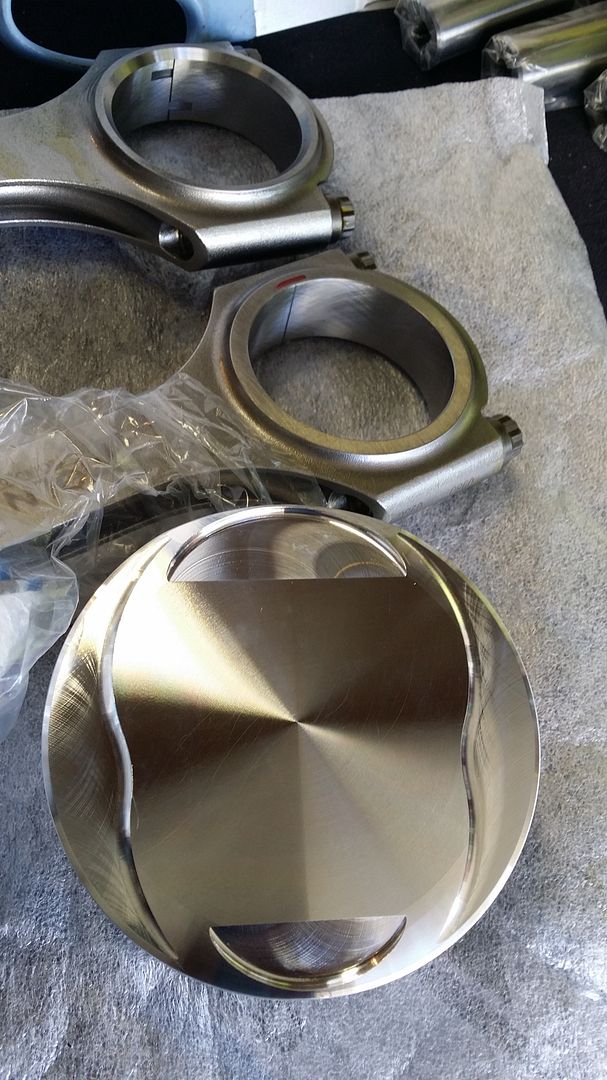

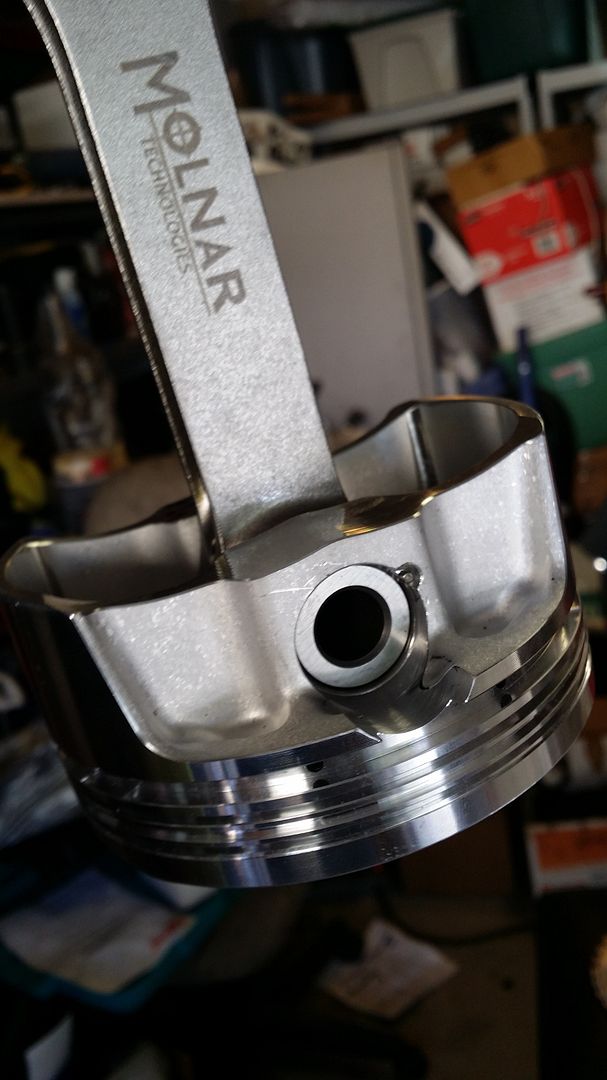

just heard from Stu..my piston CR is 10.75
Fred, didn't you also mill the heads? That's going to make a tight motor for the street.

hi David...sorry I didn't respond, I figured I had plenty of time since I was just gettin all my parts together and at the moment the block is at the machine shop...I'll let you know as the time gets closer...Stu did mention that he wanted to do my tune but we'll see...

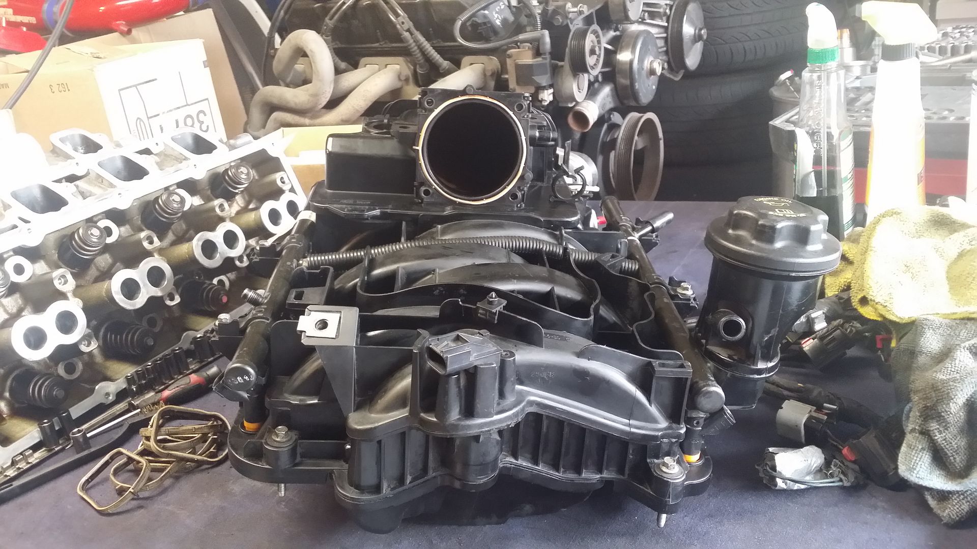

see the difference between the 5.7 injectors and the 6.1 injectors....
That really places the nozzle low in the port. I always assumed the flow was just increased. There is also injector timing to consider. How does the 5.7 compare to the 6.1 table?

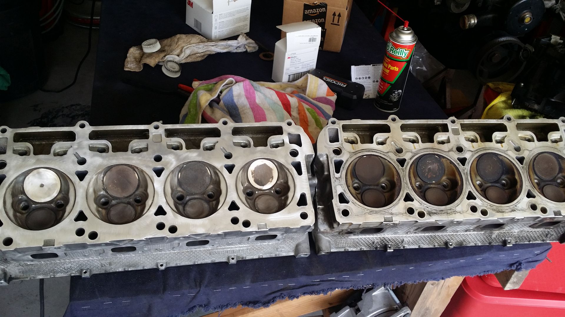

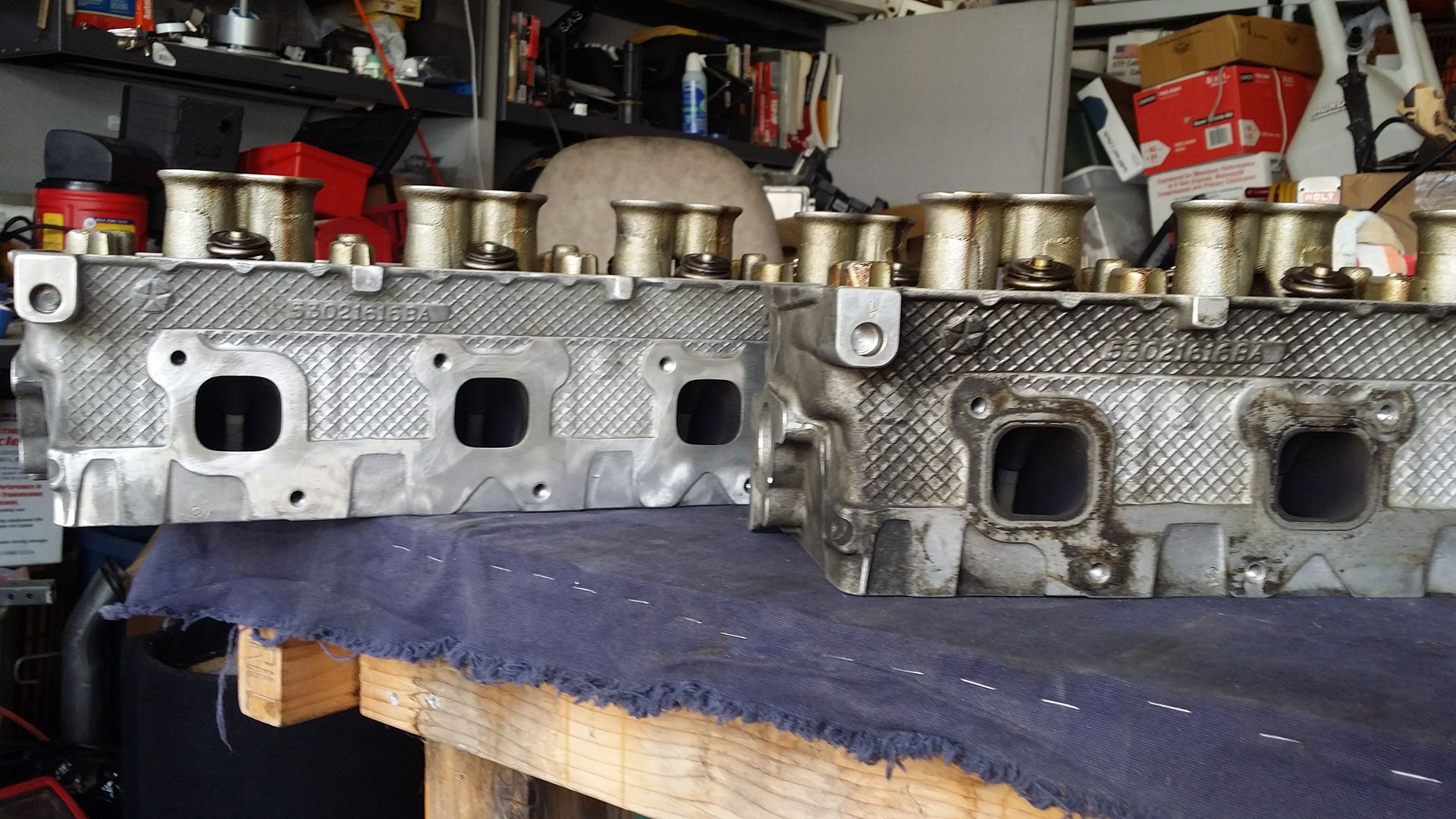

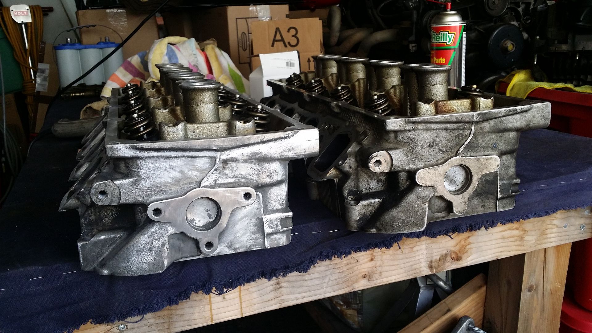

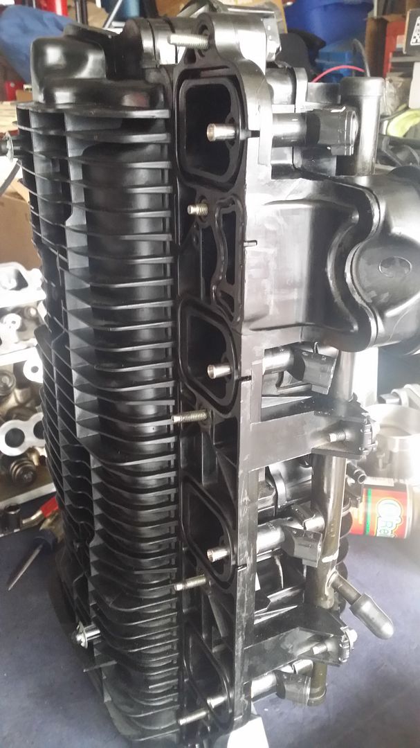

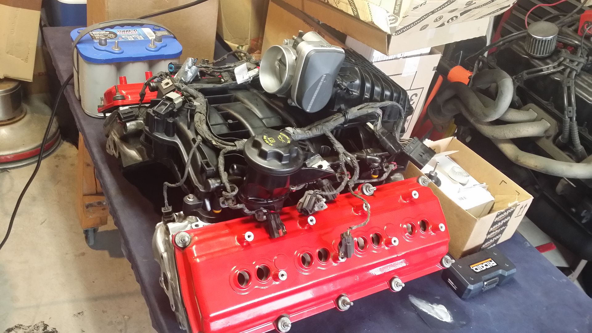

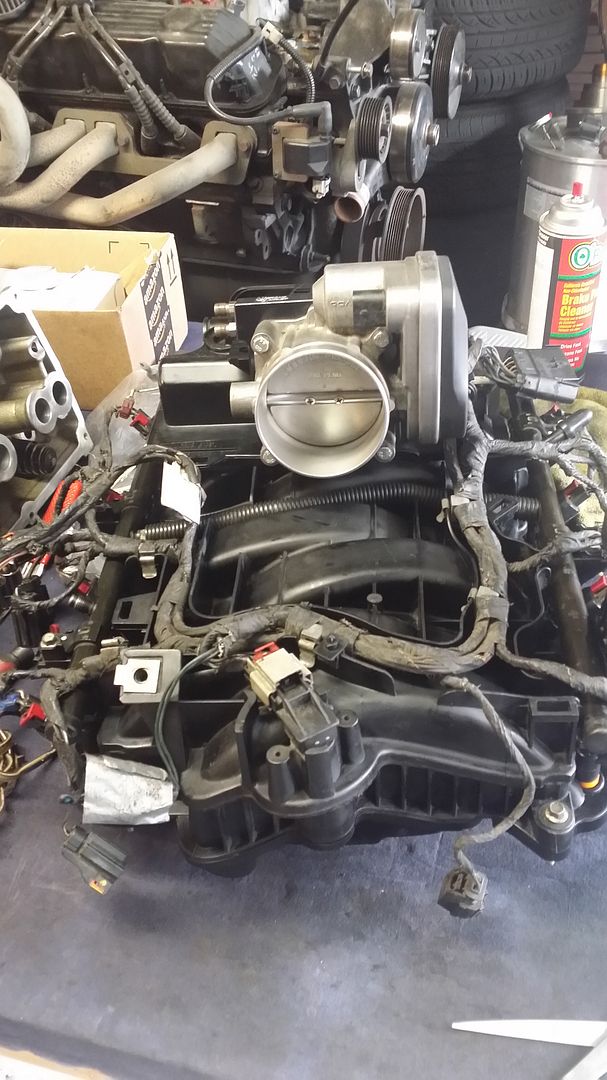

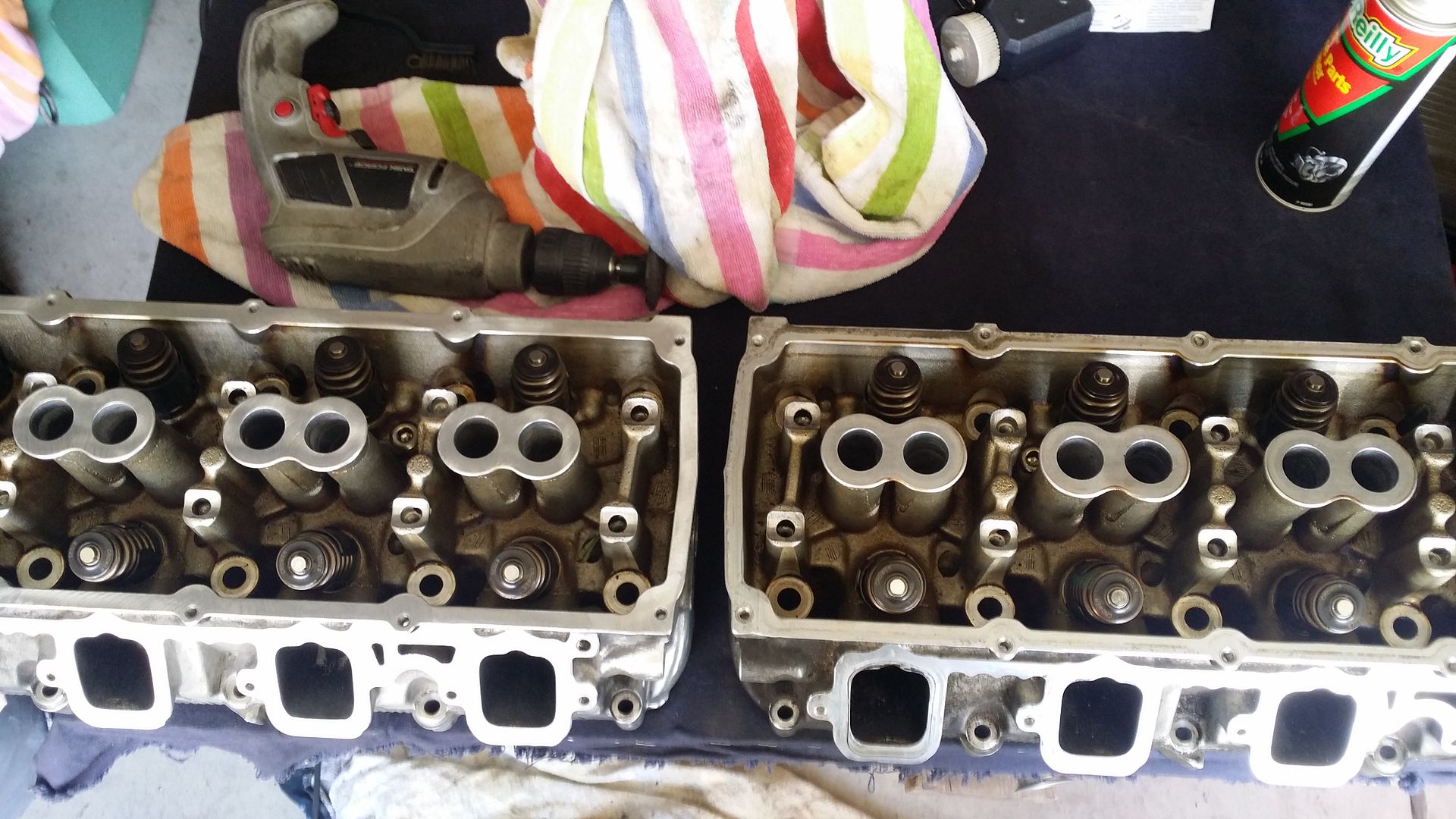

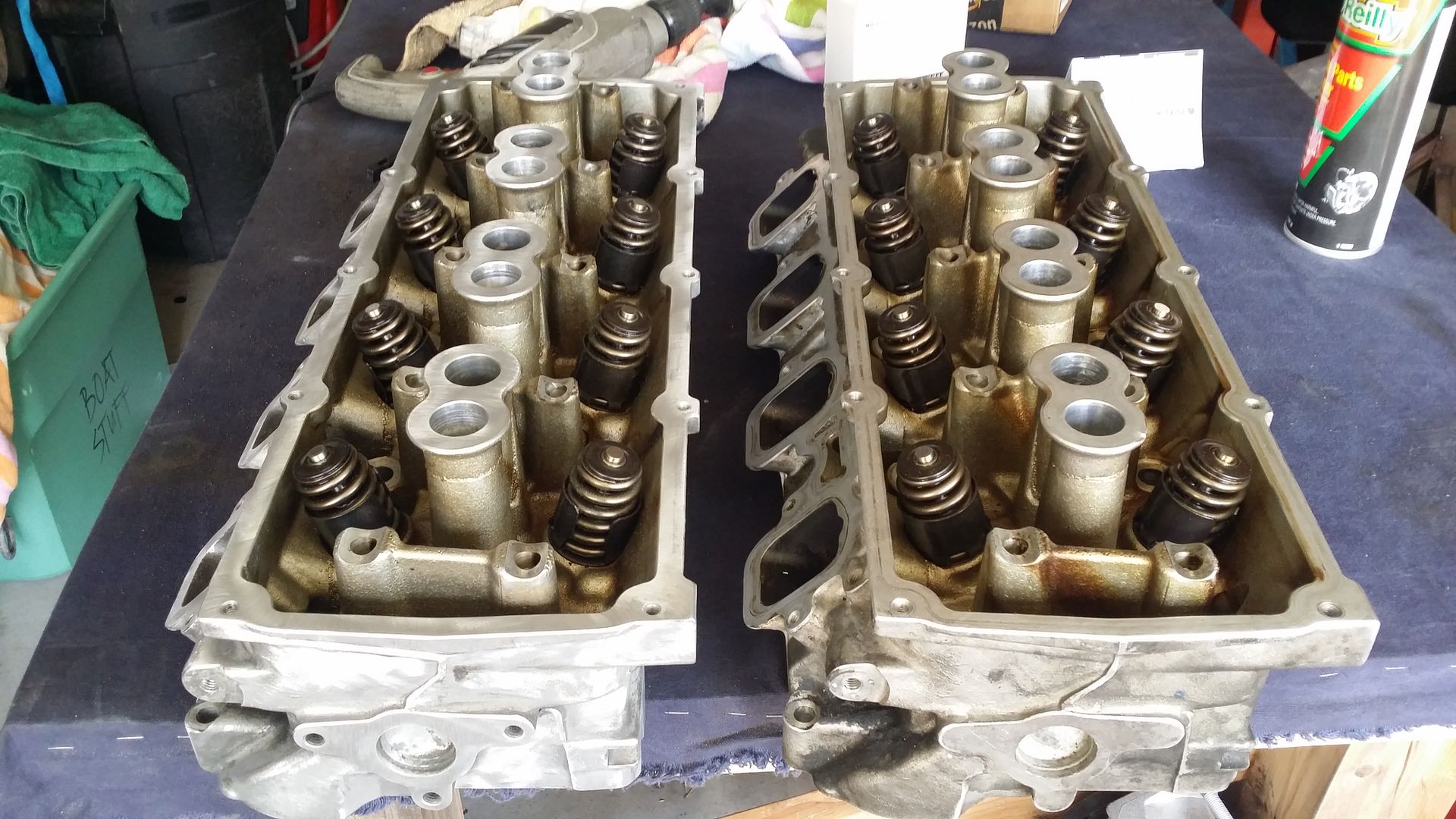

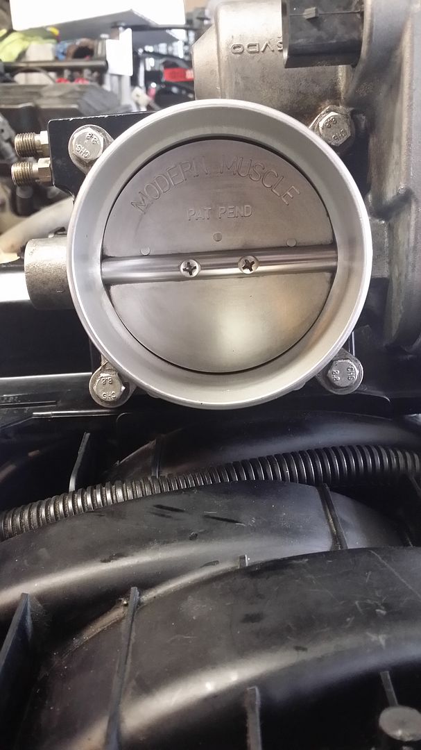

update for today...block should be back this week so I took the time to clean up the heads and intake manifold, also installed the srt 6.1 fuel injectors, cleaned the throttle body and hehe, kinda put some stuff together.. :)
