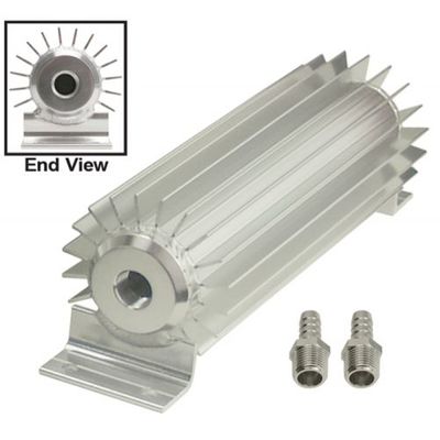

UN-believably GREAT write up !!!! You said it was possible to skip the connection to the radiator and use a cooler only, as long as it were in a warm place???
I have done my swap and bought a new radiator, but now see there are no cooler lines.
Since I live in Florida and will only drive it on nice sunny days, can I run the cooler only and stay in the temperature zone you mention?

Trans coolers are just that they cool and work great. The radiator coolers are not so much coolers but normalizers they will try and keep the trans the same temp and the engine. So if you run a free flowing line setup and good cooler it will run below 200 most times 170 all the time

what Charged392 said is correct.
The fluid was designed to run hot and the transmission was designed to run with hot fluid, and I have always found it performs best when it is nice and warm. personally I would say to run a heat exchanger with your coolant and see how it performs in your climate.
it will get the fluid up to temp quickly, which is what you want to do. if you find it gets and stays too warm, install an electric 3 position valve inline on your atf supply line to the heat exchanger, and run the valve NO to the heat exchanger and NC to a cooler, and then wire it up to a thermostat. during normal operation it will circulate your fluid through the heat exchanger, but if it gets too hot then the valve changes the flow to go through a cooler to take some heat out of it.
if your motor temps stay around 180-190, I would say that a heat exchanger would be the best route. it will keep you close to engine temp which is where you want to be anyways. check into the marine oil cooler I referenced in my writeup, they have several different sizes and they're compact and very effective to warm the fluid quickly and keep it at the desired temperature, and you will likely find that you don't even need a separate cooler unless you are running a 200+ degree thermostat in the motor and running the truck around road courses.
Thank YOU so much !!!! I have Literally lost sleep over this.
