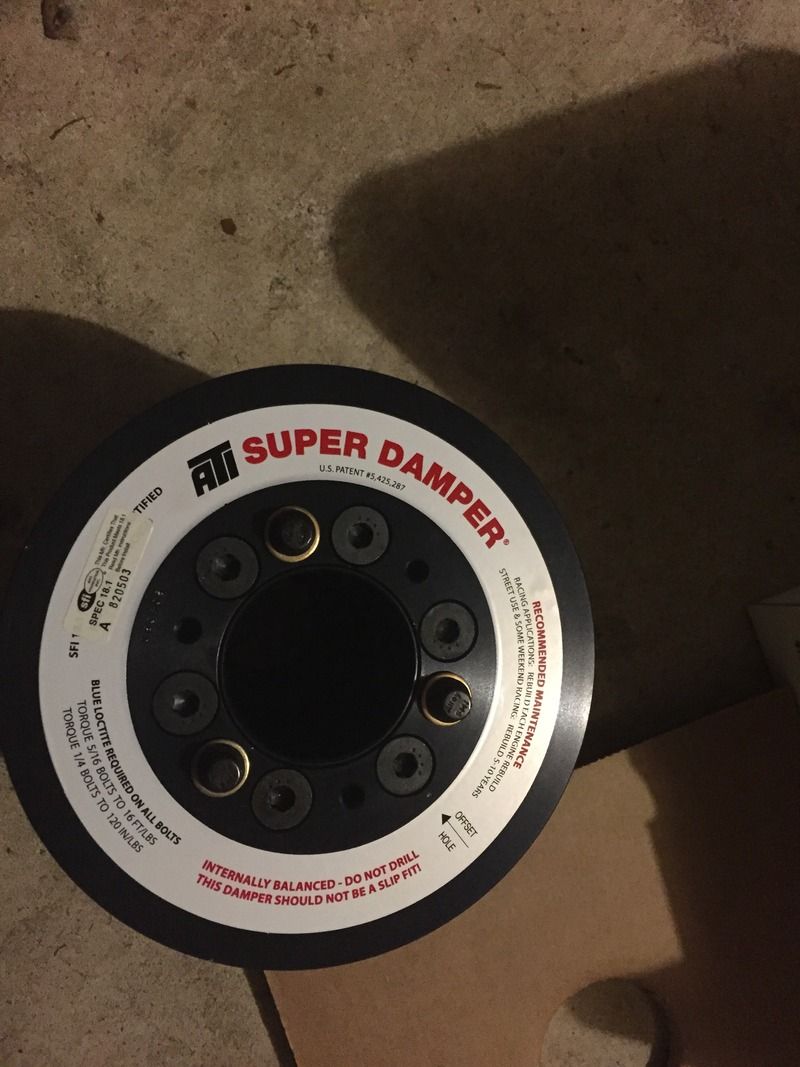

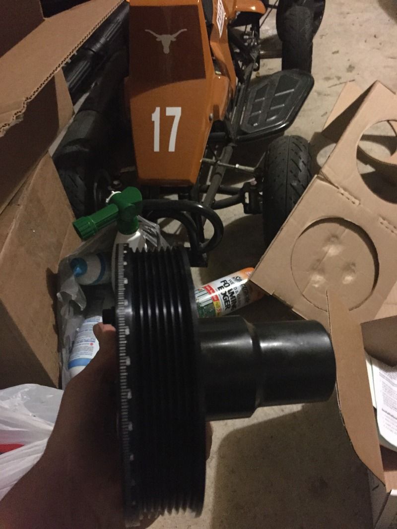

Well getting my truck to Sam has been difficult. So I found a shop here to do it. Driving 3 hours and having someone follow me just wasn't working. I drop the truck off on the 27th. I'm hoping to get my headers ceramic coated while there off. I also picked up an ATI 15% UD pulley. I'm ready to get this done.
