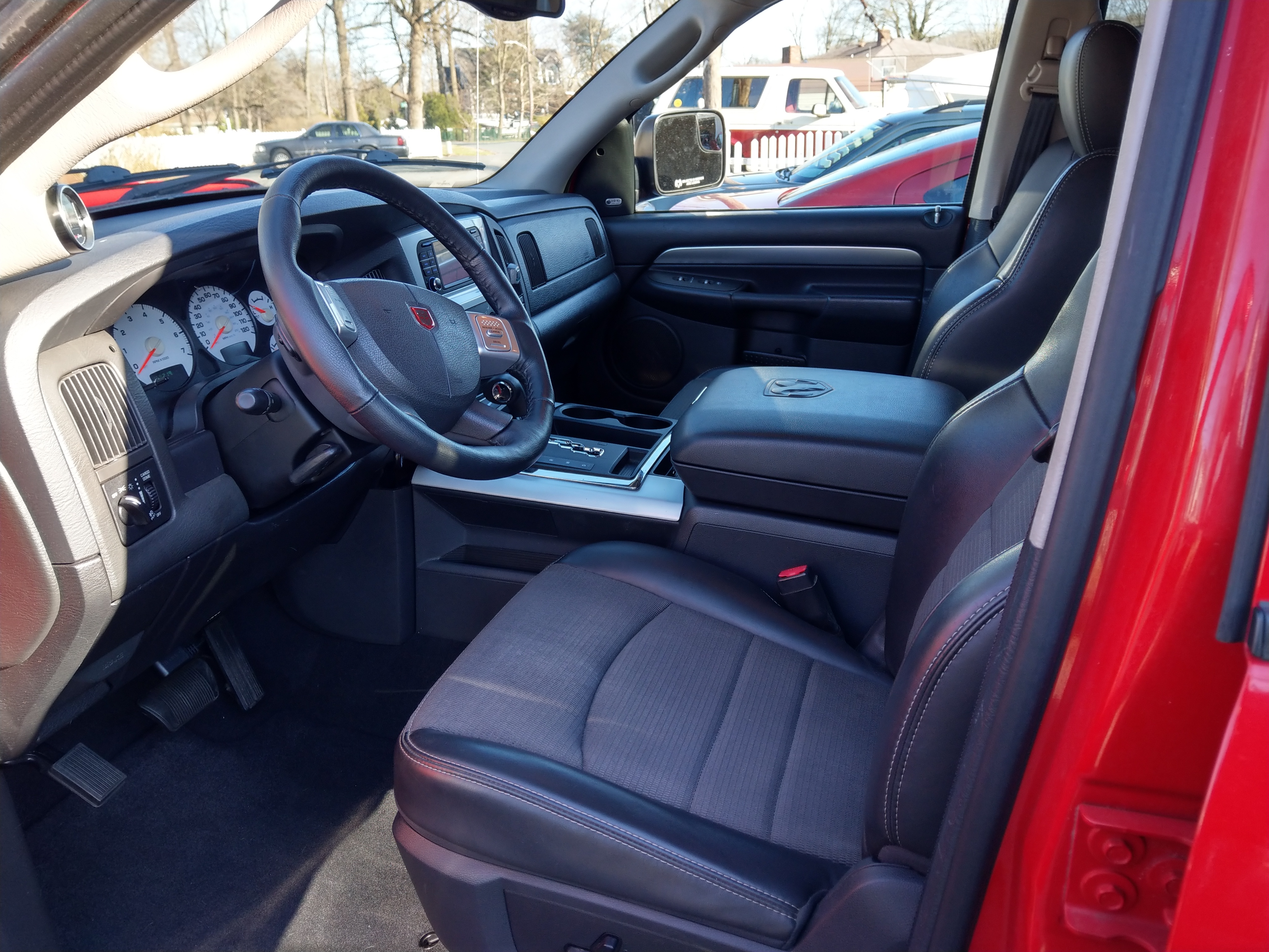

It's definitely on my to do list, but it's below engine mods & new tires, especially after finishing this:
please explain the door panels and steering wheel.... they're the same as mine... but NICER.... what did they come out of? laramie?
hard to see but steering column too? deleted column shifter?
yeah yeah 4th gen seats and console... "on my to do list" lol
....but that steering wheel!
SRT door panels as well as the center bezel. Matches the console bezel very nicely. Floor shift to go with console. Bezel is new but for a stick shift 4.7 truck. Steering wheel is a Grant: Grant Products 64037 Grant O.E.M. Replacement Steering Wheels | Summit Racing
wanna elaborate? im not sure i know what you mean. too many bezels. lol
the shifter didn't come with the console?
the shifter came from a 4.7 truck?
bezel is new.
also black dash... that came from the SRT too eh? found a good wrecker did ya? i doubt they were new-old stock.
steering console housing from a manual truck to delete the tree column shifter? or did you swap the whole column?
bezel is new.
Sorry, the bezel (center) is from the SRT truck.
The COLUMN SHROUD (this is why I probably shouldn't post late at night lol) is from a 4.7 stick shift truck.
The shifter is from a 4th gen auto and came with the console.
No, dark gray dash is my stock one: dark slate gray color code:
Gotcha Thanks.
I guess i havent seen a dark grey interior in the wild... not many lone star gen 3s up here.
